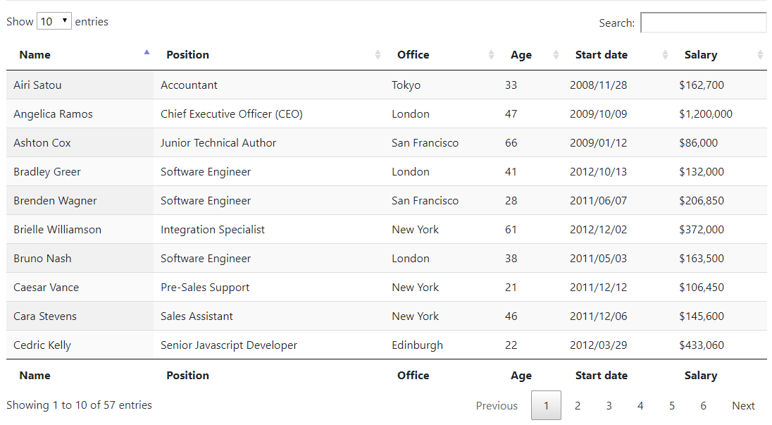

$(document).ready( function () {
    $('#myTable').DataTable();
  1. 完成以上两步可以看到页面效果如下

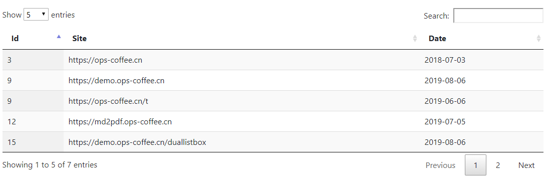

从数组中获取
<table id="myTable-x" class="display" style="width:100%"></table>
$(document).ready(function() {    var dataSet = [
      ["3","https://ops-coffee.cn","2018-07-03"],
      ["9","https://demo.ops-coffee.cn", "2019-08-06"],
    $('#myTable-x').DataTable({        "data": dataSet,        "columns": [
          { title: "Id" },
          { title: "Site" },
          { title: "Date" },
data: 指定数组
columns: 配置每一列的title
注意:从数组中获取数据一定要有表头,如果没有则可能会报下边的错:
Uncaught TypeError: Cannot read property 'aDataSort' of undefined
解决方法就是datatables添加columns配置,或者写上table的thead

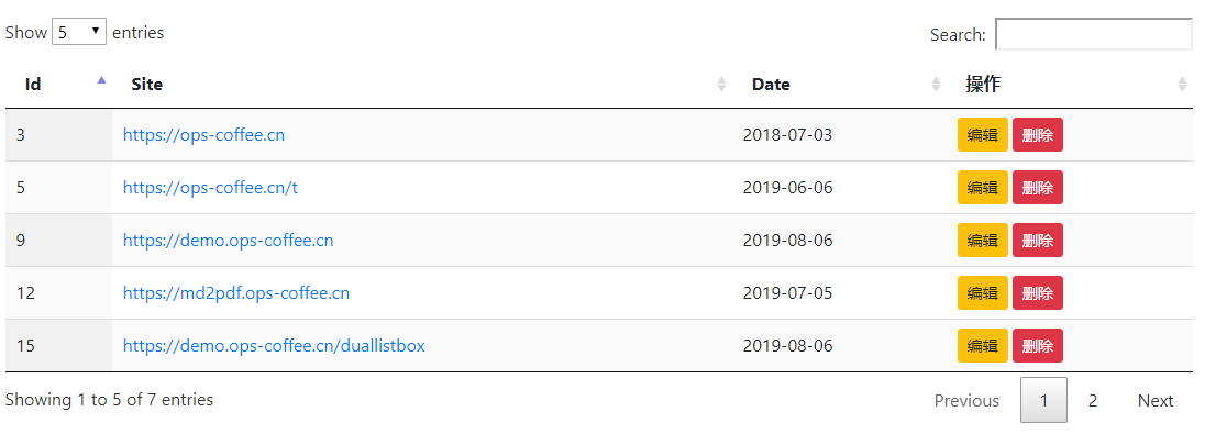

当然也可以通过columns在表格末尾添加一列以实现编辑、删除的按钮展示
"columns": [
    {"data": "id", "title":"Id"},
    {        "data": "site",
        "title":"Site",        "render": function (data, type, row) {          return '<a href='+data+' target="_blank">'+data+'</a>'
    {"data": "date", "title":"Date"},
      "data": "id",      "title": "操作",      "render": function (data, type, row) {        return '<a href="#update/'+row.id+'/" class="btn btn-warning btn-sm">编辑</a> ' +               '<a href="#delete/'+row.id+'/" class="btn btn-danger btn-sm">删除</a>'
最终呈现结果如下图

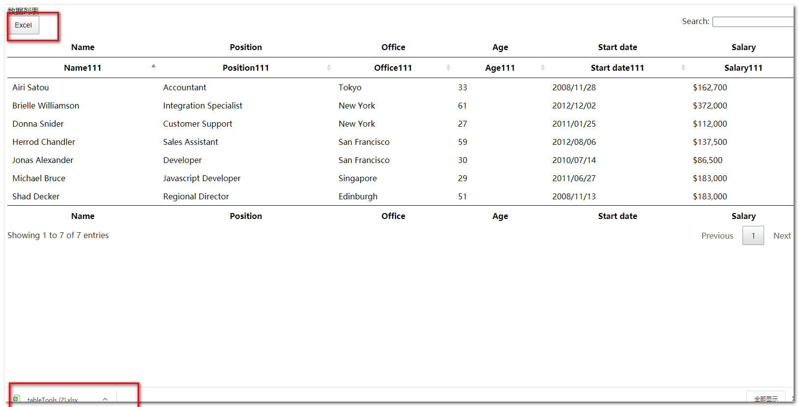

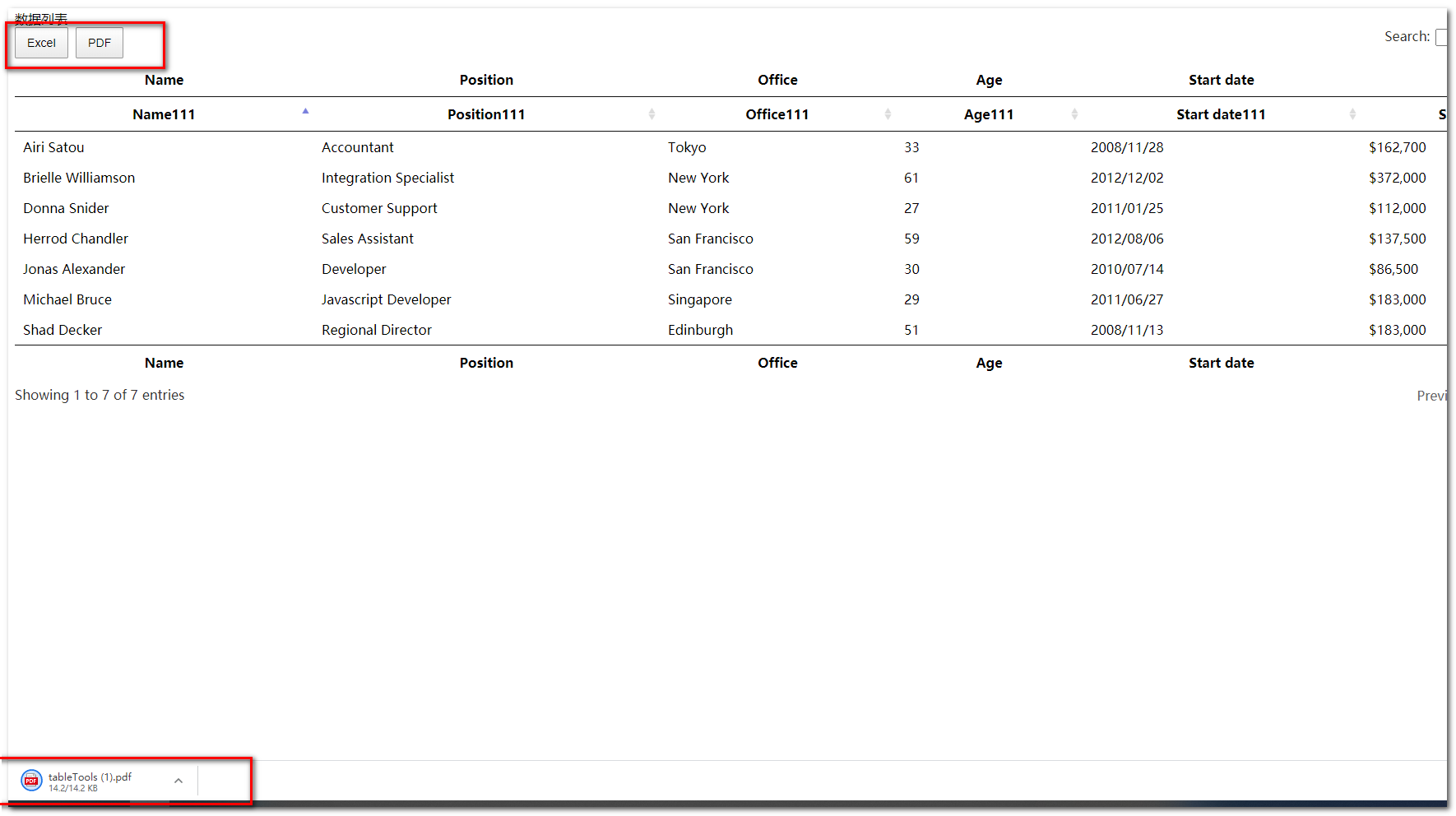

导出
https://datatables.net/download 官方下载
导出Excel
<!DOCTYPE html><html lang="en"><head>
    <meta charset="UTF-8">
    <title>tableTools</title>
    <!-- jQuery -->
    <script type="text/javascript" charset="utf8" src="http://code.jquery.com/jquery-1.10.2.min.js"></script>
    <!--datatables 的样式和导出excel的js-->
    <link rel="stylesheet" type="text/css" href="https://cdn.datatables.net/v/dt/jszip-2.5.0/dt-1.10.21/b-1.6.2/b-flash-1.6.2/b-html5-1.6.2/datatables.min.css"/>
    <script type="text/javascript" src="https://cdn.datatables.net/v/dt/jszip-2.5.0/dt-1.10.21/b-1.6.2/b-flash-1.6.2/b-html5-1.6.2/datatables.min.js"></script>
    <script>
        $(document).ready(function () {
            $('#myTable').DataTable({                dom: 'Bfrtip',                buttons: [                    'excelHtml5',
        });    </script></head><body><div class="col-md-12 col-sm-12">

运行结果
导出PDF
pdf是不支持中文的暂时无解决方案

    <script>
            $('#myTable').DataTable({                dom: 'Bfrtip',                buttons: [                    'excelHtml5',                    'pdfHtml5',
    <!-- BEGIN EXAMPLE TABLE PORTLET-->
    <div class="portlet box blue-hoki">
        <div class="portlet-title">
            <div class="caption">
                <i class="fa fa-list"></i>数据列表            </div>
            <div class="tools">
            </div>
        </div>
        <div class="portlet-body">
            <table id="myTable" class="table table-striped table-bordered table-hover"
                   style="width:100%">

运行效果
导出按钮的配置
例:
dom: 'Bfrtip',buttons: [
{    //按钮    extend: "copy",    //按钮名称    text: '复制',    //按钮的class名称
    className : 'export-btn'},
{    extend: "excelHtml5",    text: '导出excel',
{    extend: "copy",    text: '导出pdf',
    },    //'copy', 'excelHtml5','pdfHtml5'],
所有配置选项
https://datatables.net/reference/option/buttons.buttons
