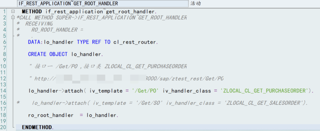

一、代码过程

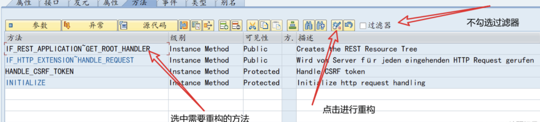

使用SE24创建一个类 ZLOCAL_CL_REST,并且继承超类 CL_REST_HTTP_HANDLER 。
重构方法 IF_REST_APPLICATION~GET_ROOT_HANDLERHANDLE_CSRF_TOKEN,其中HANDLE_CSRF_TOKEN 是用于token验证的,如果不需要token验证则直接重构即可,不需要代码,需要验证的话可以保留,无需重构。
重构的代码,其中/GET/PO 为接口路径,ZLOCAL_CL_GET_PURCHASEORDER 为接口类

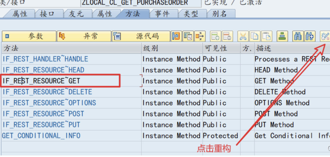

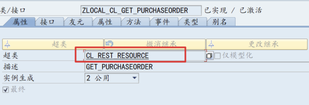

  • 上述完成后,再次使用SE24 创建一个类,类名为前面的接口类 ZLOCAL_CL_GET_PURCHASEORDER.并且继承超类 CL_REST_RESOURCE
继承后,根据接口的不同调用方式,重构相应的方法

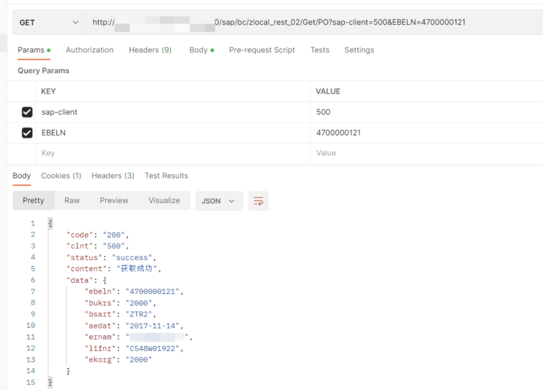

这里使用GET方式进行演示
  METHOD if_rest_resource~get.*CALL METHOD SUPER->IF_REST_RESOURCE~GET*    .    DATA: lv_output_json TYPE string.    DATA: lv_ebeln TYPE ebeln.    DATA: BEGIN OF ls_out,            ebeln TYPE ebeln,            bukrs TYPE bukrs,            bsart TYPE bsart,            aedat TYPE aedat,            ernam TYPE ernam,            lifnr TYPE lifnr,            ekorg TYPE ekorg,          END OF ls_out.    DATA: BEGIN OF ls_output,            code    TYPE char3,            clnt    TYPE sy-mandt,            status  TYPE char10,            content TYPE string,            data    LIKE ls_out,          END OF ls_output.          DATA(rt_parameters) =  mo_request->get_uri_query_parameters( )." 获取参数 "          LOOP AT rt_parameters ASSIGNING FIELD-SYMBOL(<fs_par>).      TRANSLATE <fs_par>-name TO UPPER CASE.      TRANSLATE <fs_par>-value TO UPPER CASE.    ENDLOOP.    ls_output-clnt = sy-mandt.    READ TABLE rt_parameters INTO DATA(ls_par) WITH KEY name = 'EBELN'.    IF sy-subrc IS INITIAL AND ls_par-value IS NOT INITIAL.      CALL FUNCTION 'CONVERSION_EXIT_ALPHA_INPUT'        EXPORTING          input  = ls_par-value        IMPORTING          output = lv_ebeln.      SELECT SINGLE * INTO CORRESPONDING FIELDS OF ls_out FROM ekko        WHERE ebeln = lv_ebeln.      IF sy-subrc IS INITIAL.        ls_output-data = ls_out.        ls_output-code = cl_rest_status_code=>gc_success_ok.        ls_output-status = 'success'.        ls_output-content = '获取成功'.      ELSE.        ls_output-data = ls_out.        ls_output-code = cl_rest_status_code=>gc_success_ok.        ls_output-status = 'fail'.        ls_output-content = '获取失败'.      ENDIF.    ELSE.      ls_output-data = ls_out.      ls_output-code = cl_rest_status_code=>gc_redirection_permanent.      ls_output-status = 'fail'.      ls_output-content = '参数错误'.    ENDIF.
   /ui2/cl_json=>serialize(   EXPORTING     data          = ls_output     compress      = abap_false     pretty_name   = /ui2/cl_json=>pretty_mode-camel_case   RECEIVING     r_json        = lv_output_json ).    " 响应内容"    mo_response->create_entity( )->set_string_data( lv_output_json ).    " 响应内容类型 : application/json"    mo_response->create_entity( )->set_content_type( iv_media_type = if_rest_media_type=>gc_appl_json ).    " 响应状态 : 非必须"    mo_response->set_status( cl_rest_status_code=>gc_success_ok ).    " 响应说明  : 非必须"    mo_response->set_reason( cl_rest_status_code=>get_reason_phrase( cl_rest_status_code=>gc_success_ok ) ).  ENDMETHOD.

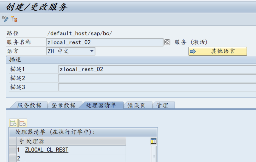

二、使用SICF配置服务
配置如下,处理器为 ZLOCAL_CL_REST ,即第一次创建的类。
三、Postman 测试
1、正确调用

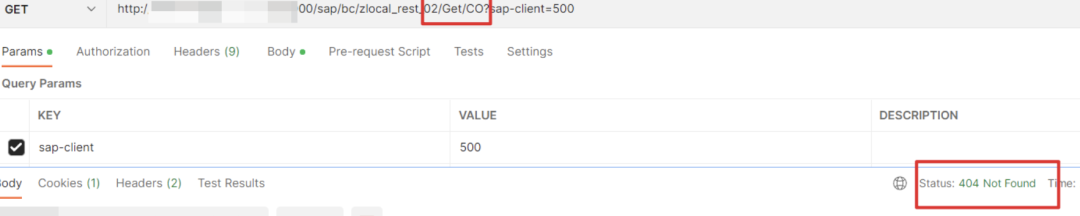

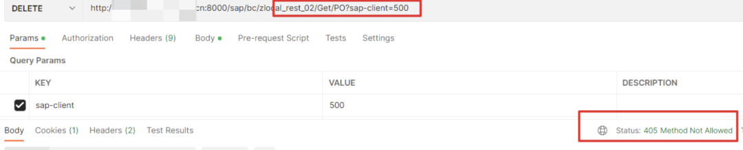

如果路径不正确会提示没有合适的资源。
方法没启用,提示不受支持。

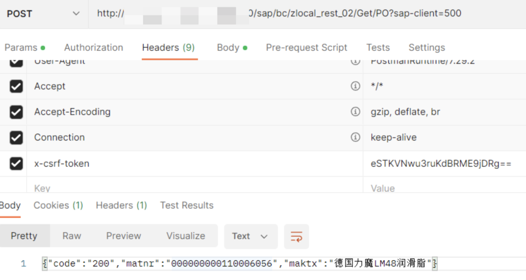

使用token
  1. 使用token 需要在 POST 方式调用,先对类ZLOCAL_CL_GET_PURCHASEORDER中的方法IF_REST_RESOURCE~POST 重构,为了测试这里简单重构了。
METHOD if_rest_resource~post.  TYPES:BEGIN OF ts_indata,          matnr TYPE matnr,          maktx TYPE maktx,        END OF ts_indata.  DATA: ls_data TYPE  ts_indata.  TYPES: BEGIN  OF ts_outdata,           code TYPE char3.      INCLUDE TYPE ts_indata.  TYPES:        END OF ts_outdata.  DATA: ls_outdata TYPE ts_outdata.  " POST 方式传入参数,JSON"  DATA(lv_input_json) = io_entity->get_string_data( ).
 " JSON 转换为内表"  /ui2/cl_json=>deserialize(    EXPORTING      json = lv_input_json    CHANGING        data = ls_data ).
 CALL FUNCTION 'CONVERSION_EXIT_MATN1_INPUT'    EXPORTING      input        = ls_data-matnr    IMPORTING      output       = ls_data-matnr    EXCEPTIONS      length_error = 1      OTHERS       = 2.
 SELECT SINGLE maktx FROM makt INTO ls_data-maktx WHERE matnr = ls_data-matnr.
 " 内表转换JSON"  DATA: lv_output_json TYPE string.
 MOVE-CORRESPONDING ls_data TO ls_outdata.
 ls_outdata-code = cl_rest_status_code=>gc_success_ok .
 /ui2/cl_json=>serialize(     EXPORTING       data          = ls_outdata       compress      = abap_false       pretty_name   = /ui2/cl_json=>pretty_mode-camel_case     RECEIVING       r_json        = lv_output_json ).
 " 响应内容"  mo_response->create_entity( )->set_string_data( lv_output_json ).  " 响应状态 : 非必须"  mo_response->set_status( cl_rest_status_code=>gc_success_ok ).  " 响应说明  : 非必须"  mo_response->set_reason( cl_rest_status_code=>get_reason_phrase( cl_rest_status_code=>gc_success_ok ) ).ENDMETHOD.
  • 对请求添加Basic Authentication账号密码,否则无法获取。

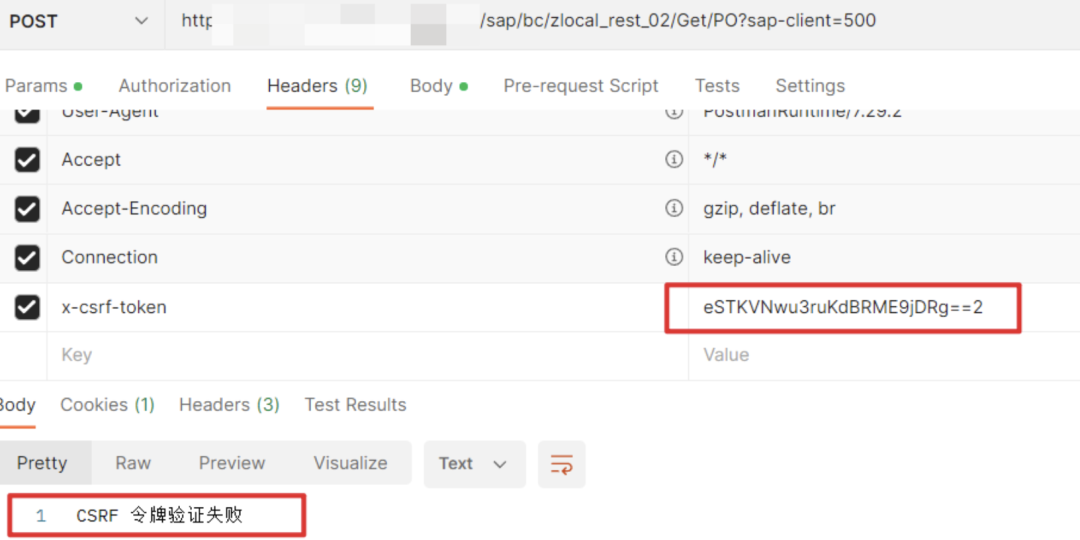

  • 使用Postman 获取token
    请求的Headers 中添加 x-csrf-token 参数,值为 fetch,即可在响应的 Headers 中取得 token 值。
测试token
1、使用错误的token会提示验证失败
正确的token,验证时同样需要Basic Authentication账号密码。(你也可以在sicf里面维护固定账号密码不推荐)
