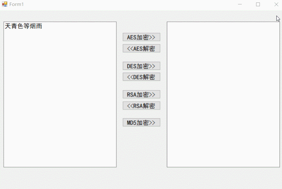

实现功能:
    • 使用DES加密方式加解密文本数据
开发环境:
开发工具:Visual Studio 2013
.NET Framework版本:4.5

  private void btn_Des_Encrypt_Click(object sender, EventArgs e)        {            string result = DesUtil.Encrypt(textBox1.Text, "12345678900987654321");            textBox2.Text = result;        }
private void btn_Des_Decrypt_Click(object sender, EventArgs e) { string result = DesUtil.Decrypt(textBox2.Text, "12345678900987654321"); textBox1.Text = result;
实现效果:
